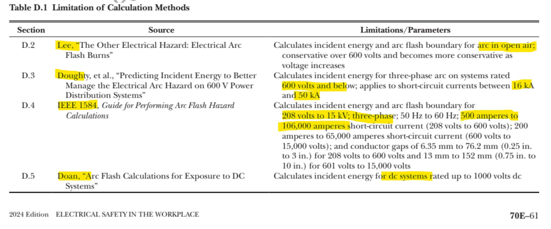

Not sure I am going to be able to help as I have not run a study with that high of available fault current. Is this part of a spot network with multiple parallel transformers? In any case, it looks like your bus voltage is 480V and the NESC and EPRI formulas are for over 15kV per the SKM setup screenshot you inserted so I don't think that is an option. Not sure why SKM would recommend those options. I don't think you can use 1584 or Doughty because your fault current is too high. According to NFPA 70E Table D.1, the Lee equations are for open air. However, I am not sure about that. There are some old threads on this forum about the Lee equation like this one: viewtopic.php?f=8&t=3590
Here is the limitations table from 70E:
Can you post a screenshot of your service up to and including switchboard? A little more context may help. Sorry I don't have any answer for you.

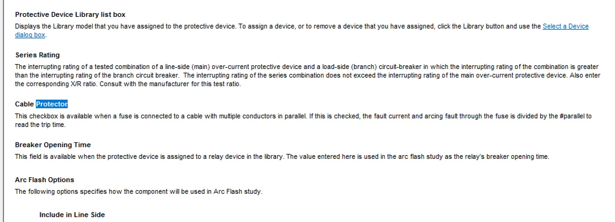

Found it. The cable protector check box appears when you have parallel sets of cable for a feeder. Checking the box will divide the fault current between the number of parallel sets, so the fault current "seen" by the cable protectors will be a half or a third, or a fourth or whatever the number of parallel sets you have and do the math for clearing based on that.

I do wonder how that tripping mechanism would play out in reality. Like I can see a scenario where the load end of the only half of the wires gets shorted; it doesn't seem like all of the cable limiters would trip in this scenario. If that is the case, there would only be INCREASED resistance (not the infinite resistance we see in an open circuit). If that's true, then dividing the available fault current at a given point does not follow the Kirchoff Current Law. The Current doesn't go from V/(5R) to V/0 (infinite, open circuit), it goes from V/(5R) to V/(4R), then V/(3R) if that cable limiter blows at all.
Guess I need to do more research on these...
