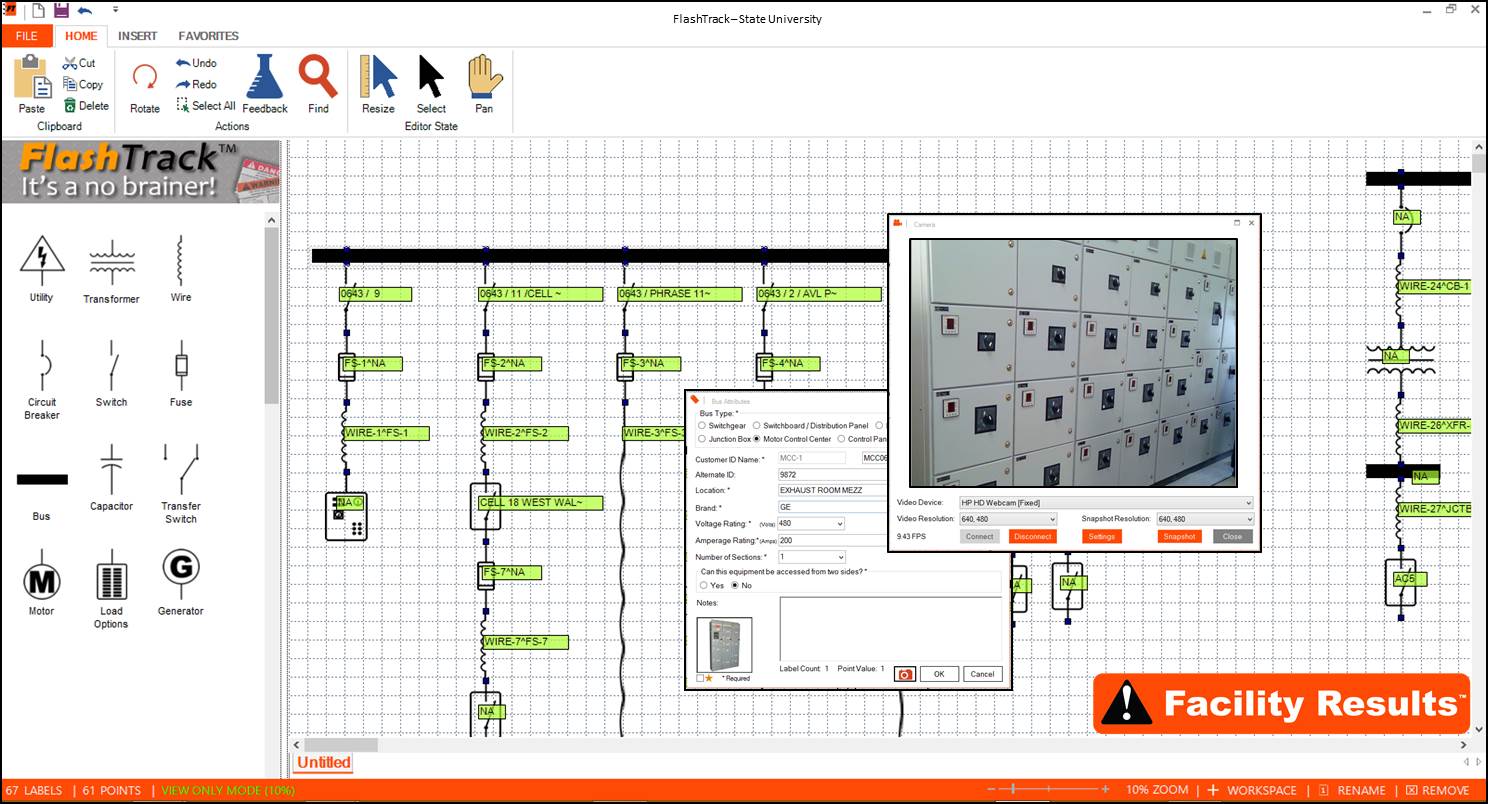

Okay, I've begun modeling some 25kV switchgear. I am new to doing this kind of arc flash study, so I could use some guidance. I've done them before on the 480V equipment. But this is just a little different to me. I have run the study and the numbers I am getting for the incident energy are a bit scary. I get 117 cal/cm^2 as the result. Seems a bit high, but I don't really know. I want to make sure my methodology is okay.
I have attached a file of the simple one line. It is a utility connected to a transformer, which has a low side breaker protection (via an SEL 351S), which is the 25kV switchgear main. In case anything is unreadable, I will retype the information here:

If anyone could take a look at what I am getting and see if I am doing it properly? This just doesn't set well with me. I really would be more comfortable if I had a second set of eyes here.

Please see attached file.
BTW I changed the CB and relay positions on your oneline.
The high incident energy (IE) is due to the lack of protective device on the transformer primary.
The IE is higher at the lineside of CB.
When you connect the load the IE is likeky to get even higher because of the load contribution to sc.
Thank you for your help. I have just now gotten the information for the hi side protective device. However, in my mind, it doesn't seem that it would really make a difference. I didn't have it at the time I did the intial calculation, but I didn't see how it would make much difference at the switchgear bus. If I am wrong in my thinking, please correct me.

It looks like, however, that my numbers were indeed correct.
To be a bit more clear, I am only really concerned with the numbers for the switchgear. We need to place the category ratings on the switchgear. This is the reason for the study.
Again, thanks so much for your help. It's good to see that I am on the right track. Perhaps this is a spot where our engineers may need to coordinate again and consider an instantaneous setting. That 30+ cycle trip time doesn't seem right to me.

The high incident energy is simply the result of almost 12 kA of arcing current that takes 600 ms to clear. Adding an overcurrent stage with faster tripping will help here, but if you make it instantaneous you'll run into coordination issues downstream.
As for the upstream data, it certainly affects the line side calculation. Although technically not 'the switchgear bus', it applies to work done at the switchgear on the incoming cubicle.

This might be a good application for a maintenance switch that asserts an input to the SEL-351. The input would be used to activate an instantaneous overcurrent element when maintenance is being performed.

SKM also defaults to using the Lee method for calculations above 15 kV. This model is known to overstate the incident energy and the amount that it overstates it increases as the voltage and/or current increases. Note also that in your SKM results, it will indicate that the results are invalid for enclosed switchgear and apply to open line gear only.
