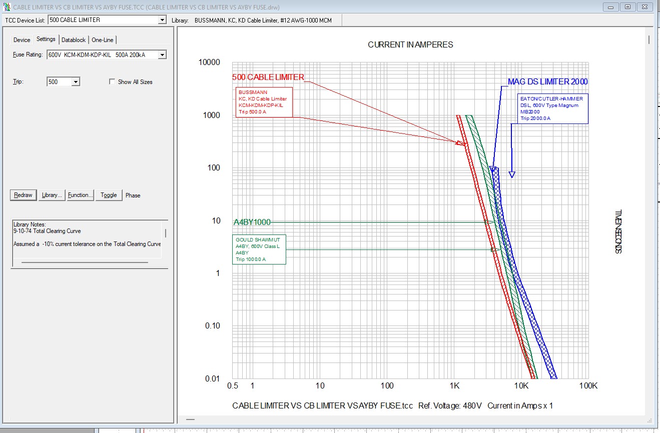

Author:  bbaumer [ Wed Mar 11, 2026 5:19 pm ]
Post subject:  Re: EPRI - Has anyone used this? 1584 O.O.B.
On my phone so short answer. The limiters are not sized by amps. They are by cable size. They are pretty much just short circuit protection for a single cable so if you have a cable fault it takes that cable out very fast and your system stays online with a little less ampacity. If you look at the TCC for a #500 limiter it would have like a 2000 or 2500 amp long time rating if it had such a rating. So no overload protection just short circuit protection.
Author:  bbaumer [ Thu Mar 12, 2026 3:26 am ]
I just went back and looked at an old job where I had compared #500 cable limiters to a Eaton Magnum DS limiter installed in the gear in series with the breaker and a fuse. It looks like my memory failed me. If the #500 cable limiter had such a thing as a long time rating, it would be around 1000 amps, not 2000-2500a that I mentioned yesterday.
