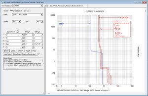

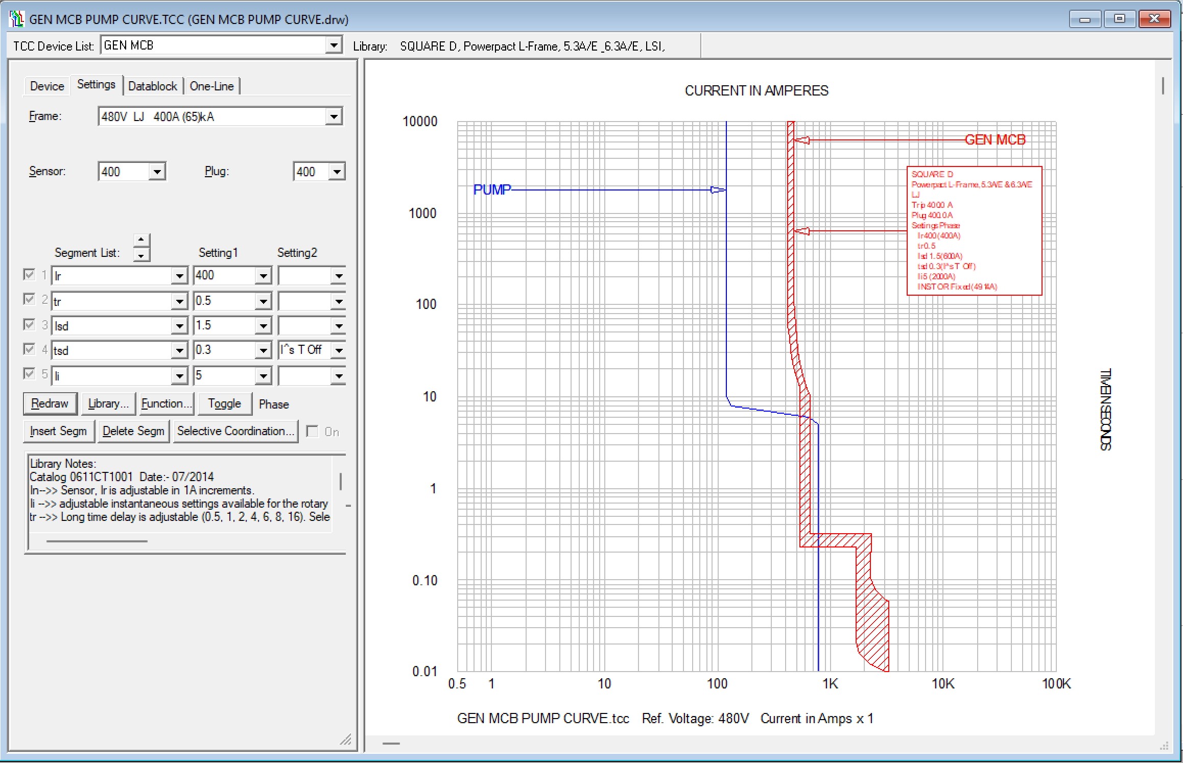

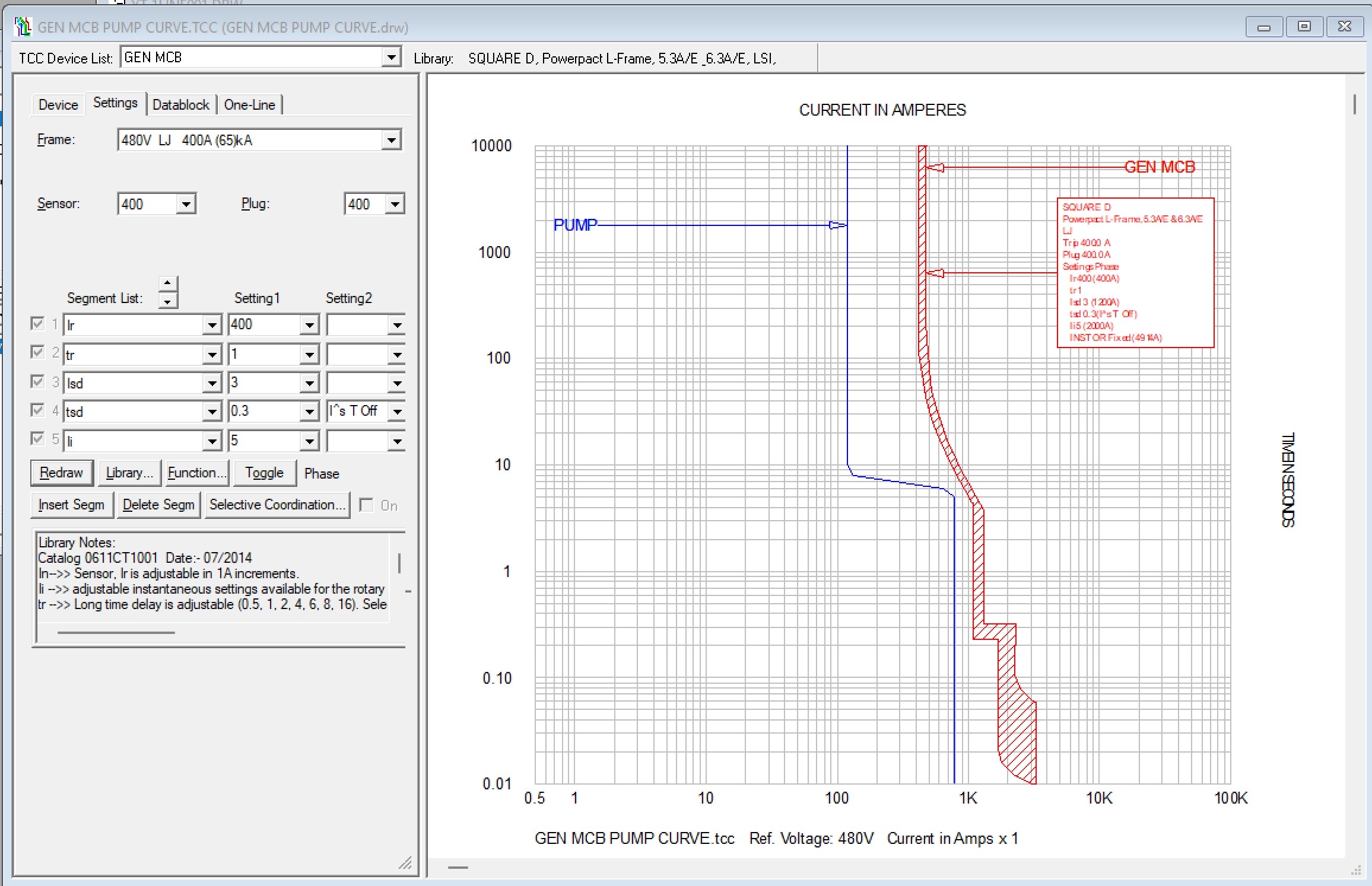

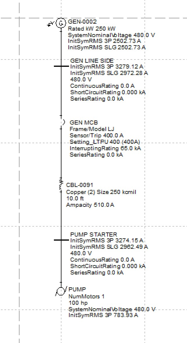

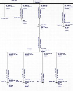

Circling back to this (and touching on a common theme talked about here), when a study indicates a generator breaker will never trip because the fault current is below 2kA (causing it to time out in software), what are the options? In a study I'm working on now, the LT pickup is 320A, the ST pickup is 3200A, and the INST is 7200A(fixed). How does one determine how far one could drop the ST pickup before I'm in danger of tripping under inrush conditions of downstream pumps?

Add the pump motor starting curve to the TCC and coordinate the breaker with the curve.

PostPosted: Fri Aug 29, 2025 3:11 am
For example
Thank you! In this particular case, the generator breaker and ATS are the points with objectionable incident energy, but there is an MCC feeding 3 motor circuits downstream and a 480V panel>transformer>208V panel situation (feeds no motors). Only one of the three motors has a VFD (which also has an RL reactor upstream, but no maintenance bypass).
Would you, in such a case, add the inrush current of the two non-VFD-controlled motors together, along with the inrush of the transformer, and adjust the curve to the sum?
Maybe. Not enough information. I can for sure model multiple motors on one feeder thereby combining their starting curves into one. I'm not sure if that is possible to add in the transformer inrush too. I might be able to build that into the controller but I've never tried. Also sizes of each would affect how I would approach it.
