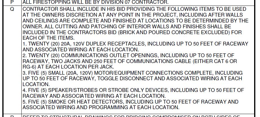

When I tell the consultants to put a general note on the drawings requiring the contractor to include a certain number extra devices to be located later on a new building or major renovation (receps, exit signs, smokes, horn/strobes, comm outlets, small equipment connections etc.) during construction they scoff at the idea. I say I can buy those recepts with the bid for $200 per now or $1200 via change order later with a whole lot more paperwork. Same with temperature control points. We always have to add some recepts, or a smoke detector, or a comm outlet here or there that was missed during design.
