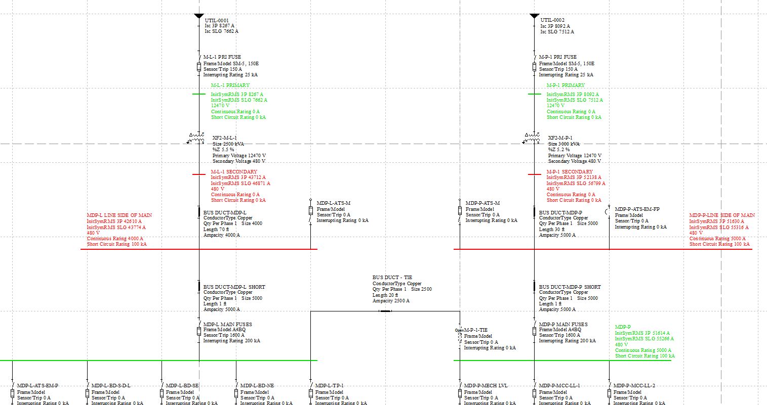

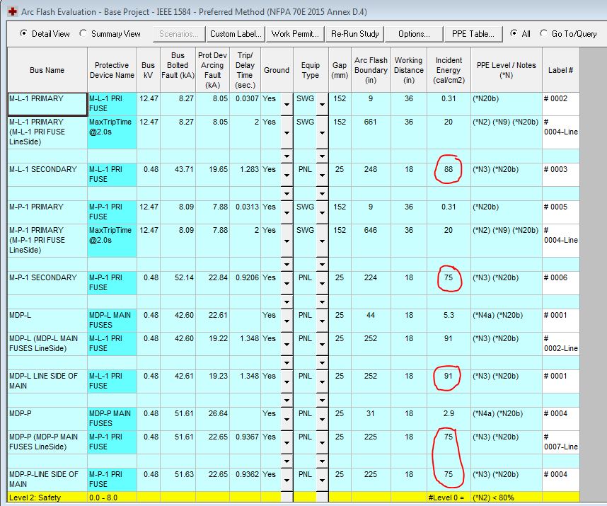

This is the highest I can think of at the moment. It's from a study I barely started modeling on a building with dual services, one 4000A and one 5000A, 480V services with tie that is kirk keyed so you can't close both mains together. I quit on the study until such time I can schedule a shutdown in order to survey these boards. I'm not comfortable opening them up live to verify cables and fuses as there are absolutely no barriers between sections so a fault at the line side of the main can blast through all sections unimpeded. You can see we've already greatly reduced the main fuse sizes from what were in there at one time due to actual load in this building being far less than the switchboards are rated for.
