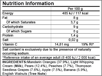

PostPosted: Sun Apr 29, 2018 3:18 pm

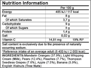

Good info everyone. A few additions. I attached an E.U. label. They even show kilo-Joules of energy in addition to kilo-calories. FYI for all, a Joule of energy is a watt-second. Good luck with the “diet math” The good news, regarding any live working and PPE standards for the IEC, calories (lower case c) is all we need.
