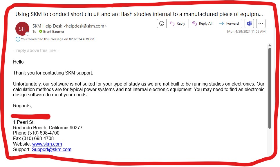

I mentioned in the video that I had asked SKM about using PTW to model the "guts" of a piece of equipment. It was basically power electronics but had terminal blocks, fuse blocks, tap conductors of different gauges, relays etc. similar to a industrial control panel but not exactly. I suspect the answer would be similar if I asked them about modeling the "guts" of a control panel but admittedly I have not tried. Here is the response I got back:
