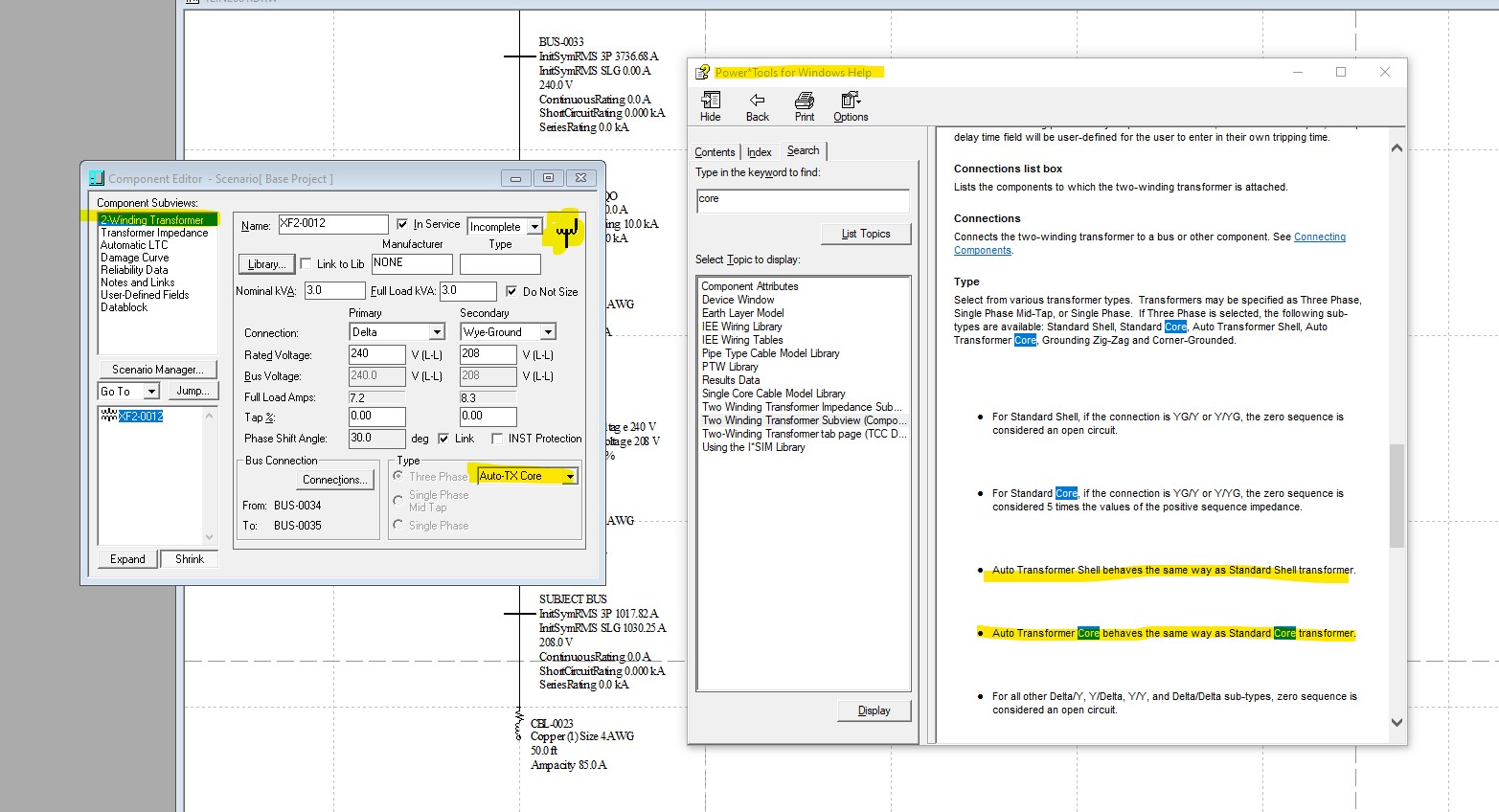

I think you're right that changing the connection type in SKM to Auto-TX Core doesn't do anything. Here's what SKM Help says on it:

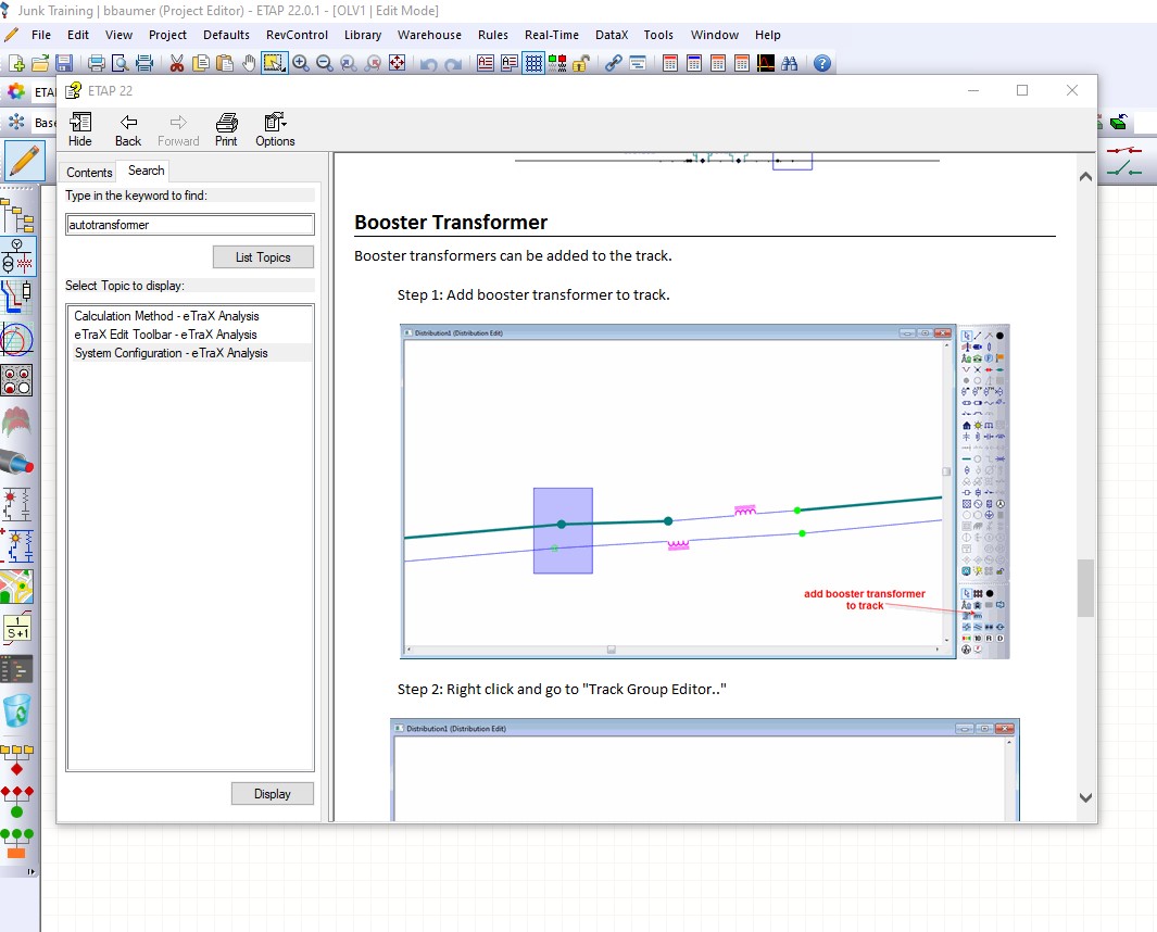

I don't know about EasyPower but I did a Help search in ETAP after I could not find that option to add an autotransformer or buck-boost in ETAP and it came back with this, among other things:
That said, my experience level with ETAP isn't nearly what it is with SKM and I have not used whatever modeling method or operation ETAP is referring t there. If you have ETAP maybe you can do a similar search and get your answers.

I will also add that I do not have the single phase module in SKM so I could not check to see if auto-transformer or buck-boost is an option in SKM if you have the single phase module. As far as I know there isn't such a thing as a 3 phase buck-boost transformer. You have to use 2 or 3 of them wired for 3 phase but I could be wrong there. Maybe you could use three single phase autotransformers wired together in the model if you have the single phase module. Not sure.
I did notice that in ETAP when I was looking at transformer attributes it does give you the option to model a three-phase transformer as 3 individual single phase cans wired for 3 phase like you'd commonly see on pole tops and sometimes in vaults.
