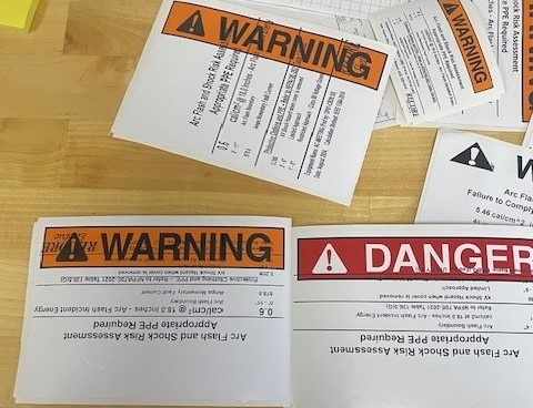

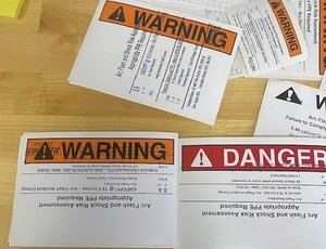

Has anyone ever encountered a problem printing from SKM or Easypower to a Brady Printer? I have a BradyS3700, and when I print directly from one of those softwares, it prints on the incorrect side. I've tried everything, from adjusting the orientation and settings. Brady tech support instructed me to use the Brady Workstation software. I know it works if I do a pdf and print but I want to directly print from SKM or Easypower.

It sounds like a driver or software compatibility issue between SKM/EasyPower and the Brady S3700. Since Brady tech support suggested using Brady Workstation, it’s likely that their printers expect a specific formatting protocol that those engineering software tools don’t fully accommodate. Try these fixes:
1. Update printer drivers to the latest version.
2. Check print settings in SKM/EasyPower (paper size, orientation).
3. Try a different print language (ZPL/EPL if supported).
4. Use a virtual printer as an intermediary.
5. Automate Brady Workstation to avoid manual PDFs.
If the issue persists, check the print processor settings in Windows.
