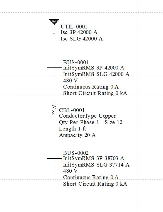

I attended a seminar today and one of the presenters claimed there is typically a significant (well over 40 calorie, even saying 60 or 80 calorie "if you do the calculation") available incident energy amount in an enclosed metering compartment of a low voltage switchboard.
He claimed this was due to the fact the voltage input for the meters are tapped ahead of the main and are therefore unprotected and even though the wire is only #12 or #14 the wire length is so short there is a tremendous amount of fault current.
I scoffed and questioned that logic thinking the withstand rating of #12 or #14 combined with impedence wouldn't allow a sustained arc flash event at all let alone over 40 calories but didn't want to get into it with the guy as it really wasn't the time or place.
Thoughts?

Thanks Paul.
I referenced withstand rating along your same line of thinking, I think.

The equations and curves posted above are for conductor damage. I am unaware of any approved methods for determining the clearing time of a #14 copper wire. Remember also that where arc flash testing is performed, arcs are generally initiated with a fine conductor that completely vaporizes without interrupting the fault.
I disagree with the statement the wire is unprotected since it is ahead of the main. The utility will have protection, even if it's on the primary side with very long clearing times. If this time exceeds two seconds, then cut it off at two seconds per IEEE.
If you are looking at this from the utility side, the NESC has a low voltage table that deals with the IE question. The table is based on testing.
In the arrester example, the utility is likely to have an upstream recloser or reclosing circuit breaker that will give the arc some time to dissipate after the wire separates.
Do not use the method you propose, it is not supportable.

By my definition, low voltage includes anything at or below 1000V. Bbaumer's figures show he is not below 300, but is operating at 480V. 480 V will sustain an arc easily.
Conductors are not fuses, they were not designed or intended to interrupt faults.

The conference publication is a little unusual in that the conductor gap was chosen as 13 mm. This is very narrow for 480 V equipment so it's not really representative, but moving on...the highest incident energy for 208 V equipment in the conference publication considering effectively "all" configurations (about 6000) of metering equipment came up with 34 cal/cm2 for the line side of a PT fuse. However it doesn't consider the likelihood of sustaining an arc which is what NESC does which gives a maximum of 4 cal/cm2 based on actual equipment tests. It gives a range of 20-157 cal/cm2 for 480 V equipment which again is based on crazy high available fault currents (up to 200 kA) and an arc gap that is not representative of 480 V equipment, and again doesn't considered sustainability when the #14 wire vaporizes leaving an arc gap of several inches or feet. On the load side it indicates that incident energy is less than 3 cal/cm2 with a 13 mm arc gap, cable size #10-#14 and under 100 feet long, and in particular that available fault current is 200 kA. Lee method is being used over 106 kA but even below that except for very low (10-15 kA) available fault currents the results don't look good.
Based on lack of documented evidence of this scenario actually happening I'm still very dubious. The conference publication shows that it is theoretically possible to cause a significant arc flash in a metering compartment where the high voltage cables are in the compartment which is often true in 600 V class equipment if the system voltage is 480-600 V. NESC gives much different results based on actual testing which shows that IEEE 1584 is not applicable here and I'm contending that it has to do with cables vaporizing. It's true that #14 or smaller wires are used as "fuses" for IEEE 1584 testing but the arc gaps are under a couple inches. In this scenario the heated air from the arc sustains the arc and there is enough mass from the busbars used that the wire is just a fuse and plays no role once the arc starts. This is very different from vaporizing a foot or conductor to where arc sustainability becomes questionable at best. However not withstanding whether or not this scenario is realistically possible, which is what I question, keying in on considerations of exposure eliminates the issue.

Actually that's the opposite of what I said. I just don't believe that the IEEE 1584 data set is relevant because it is tested using large conductors designed with a significant fault current in mind while the small instrumentation wires that are used are simply not intended to withstand a fault, relying instead on the relatively high impedance of the instrumentation to eliminate this. If a fault were to occur then it is my contention that the wire would vaporize which it does because all of the original IEEE 1584-2002 test data used a #14 wire as a "fuse". And since the distance between the PT's and the busbars is fairly long, exceeding the 6" limit of IEEE 1584 in the first place, IEEE 1584 simply cannot accurately model instrumentation cabinet conditions. Instead we need to rely on NESC for this type of information which gives ratings of <=4 cal/cm2. Since utilities make arc rated clothing mandatory is most utilities, there really isn't a reason for them to list 1.2 or 2 cal/cm2. The actual data is in various EPRI reports for the most part but this puts an upper limit on the result of 4 cal/cm2 based on actual equipment tests vs. wild conjecture based on standards that are clearly not applicable (IEEE 1584 and Lee equation).
We have been working with utilities trying to figure out the IE at meter sockets. Of course this only applies to 480V-208V three phase meters. Any other voltage would have PT's. Single phase calculations just don't exist.
I don't think you realistically can. None of the IEEE 1584 "box" models match a meter socket in any way. So the only option really is to use a table such as the one in NESC that uses EPRI data for almost all of the values and simply takes the worst case that EPRI found in testing. That way you will know that this is the worst that it can possibly get to. The meter socket designs that Eblen and Short tested are fairly easy to determine by visual inspection. I know that the desire is to do some calculation here but we don't have 300+ test data points on meter sockets. Eblen and Short might have a dozen. That's enough to upper bound the results but not to quantify them any further.
