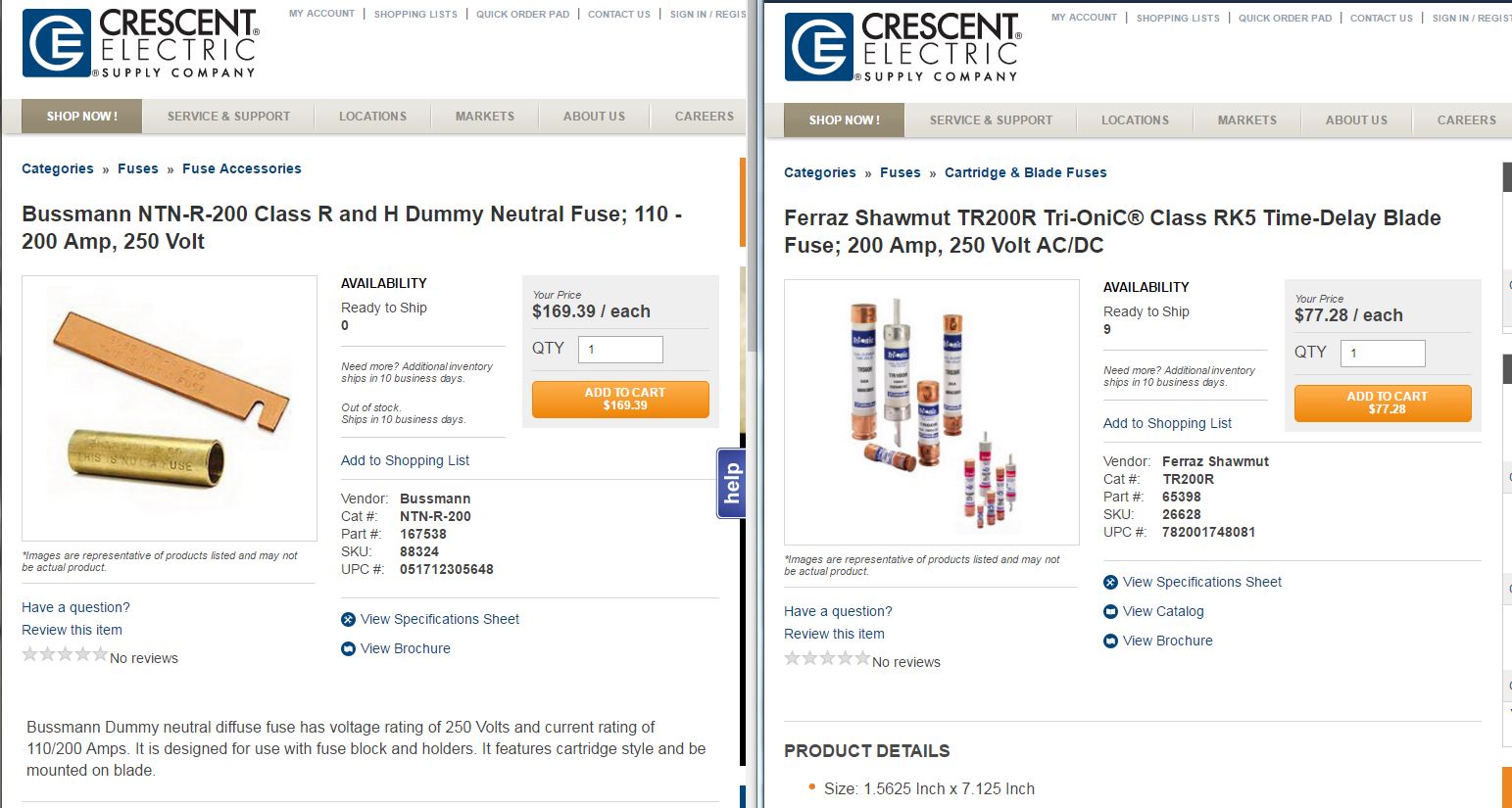

Food point about modifying. Using a roll your own slug might be considered a modification as well. Suggest using something made for the purpose. http://www.cooperindustries.com/content/public/en/bussmann/electrical/products/accessories/neutrals_.html
 Post subject: Re: Filler Bars & labels
PostPosted: Tue May 16, 2017 4:01 am
Yep. You could do that or you could just install a fuse:

Thanks for all the feedback. The fused disconnect was installed rather than the non-fused mainly because we had it. (Don't kill me, I'm just being honest.) With that being said also my NON-engineer belief was that putting identical fuses or even LPN to FRN of the same size in series like this is also not a good idea. So I'm sort of battling two beasts. Someone asked about AFC at the disconnect. It is currently about 22k but we are upgrading the upstream fuses to LPN's so I'm not sure how that changes things since the original model was with EON-200. With the filler bars installed I understand "voiding the UL listing" but I guess if I wait and get the proper parts from Bussmann that would fix that.
