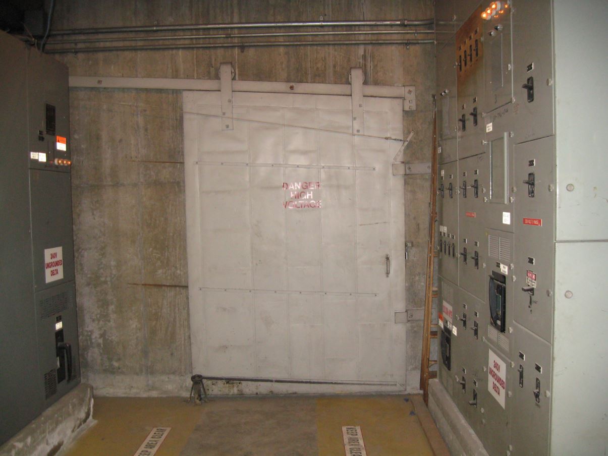

Could use a bit more info.
Are you talking about from the POCO transformer to an MCC? Voltage? Is this even a grounded wye system? Does it have a grounded neutral? Corner grounded delta? Ungrounded delta? High leg delta? Single phase?
Where I work we still have several old 240V UNGROUNDED delta services that feed nothing but motor loads. The switchboards have ground fault indicator lights on them. WIth no faults present all 3 phase lights burn dimly. When we have a ground fault the light for that phase goes out and the other two lights burn brighter. We have to start opening switches until the fault goes away and we work our way downstream from there until found.
Nothing happens when one phase has a ground fault. It just creates a pseudo corner grounded system. Only if and when a second phase goes to ground do we have fireworks.
Again, more info on the install is needed.
Thanks.
EDIT: Oh, I was able to dig up a pic of a couple of our switchboards that have the fault lights on them. See below.

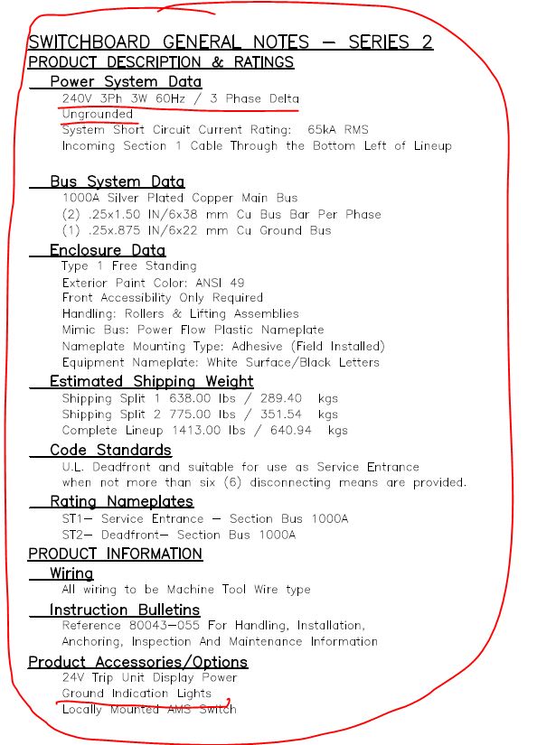

I bought a new switchboard for one of these type services a few years ago. Here were the particulars.
