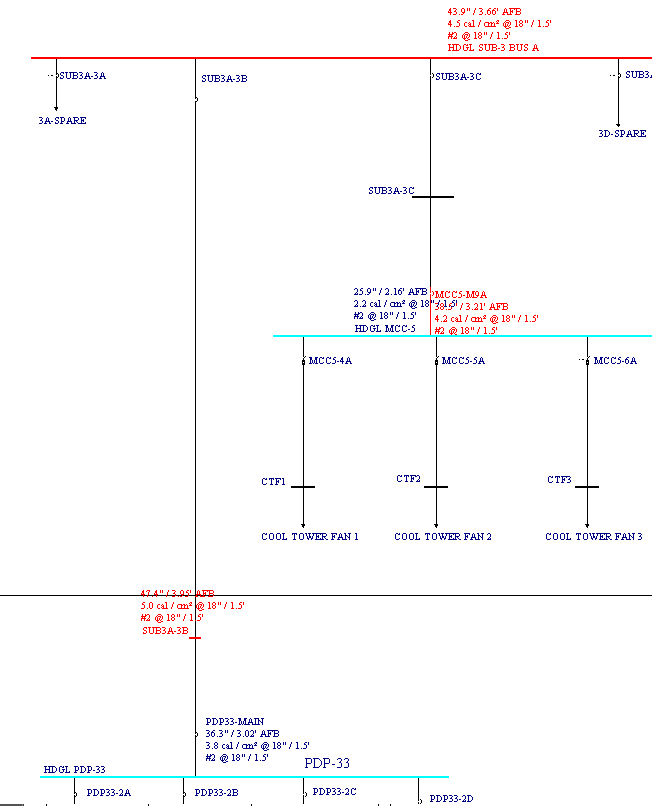

I have an existing contrition and conflicting opinions as to whether this is Code compliant or not. Please take a look at the attached PDF and comment on the wire and circuit protection sizing. Is this correct, Why or Why Not?
Thanks!!!

PostPosted: Mon Nov 07, 2011 8:48 pm
Posts: 136
- What type of wire are you using?
- By "2-1/C-4/0" do you mean 2 parallel runs of 4/0?
- Are there any other settings on the ABB S6H breaker?
By a quick look it looks not bad, but the more info you can provide the better...

Further Clarification
Thanks for your reply Glen,
Let me shed a little more light on the situation & system (I had asked the question very open/generalized as to not to lead anyone, I wanted honest interpolations/options first). This is an existing system that we are performing an Fault Current, Coordination & Arc Flash Hazard Study on. During a review the existing circuit breaker sizes vs. the wire sizes were questioned and it was suggested that the either the wire sizes or breaker sizes needed to be changed, but this is not everyone’s option. Some believe that from the Switchboard to the Starter cabinet is a feeder others believe this is a Motor Branch Circuit. I can not find in the Code where it makes a clear distinction as to how this particular installation/application would be classified. Any further clarification or comments would be greatly appreciated. See the attached sheets for more detail regarding the existing installation.

PostPosted: Thu Nov 10, 2011 6:33 am
Posts: 136
Thanx for the additional info... I did some checking with a program that is one of the best I've used for voltage drop, and conductor sizing. It shows that the conductors are sized properly for the load. I have included the link for the program I used..
http://www.mc-group.ca/voltage_drop_calculator.htm
