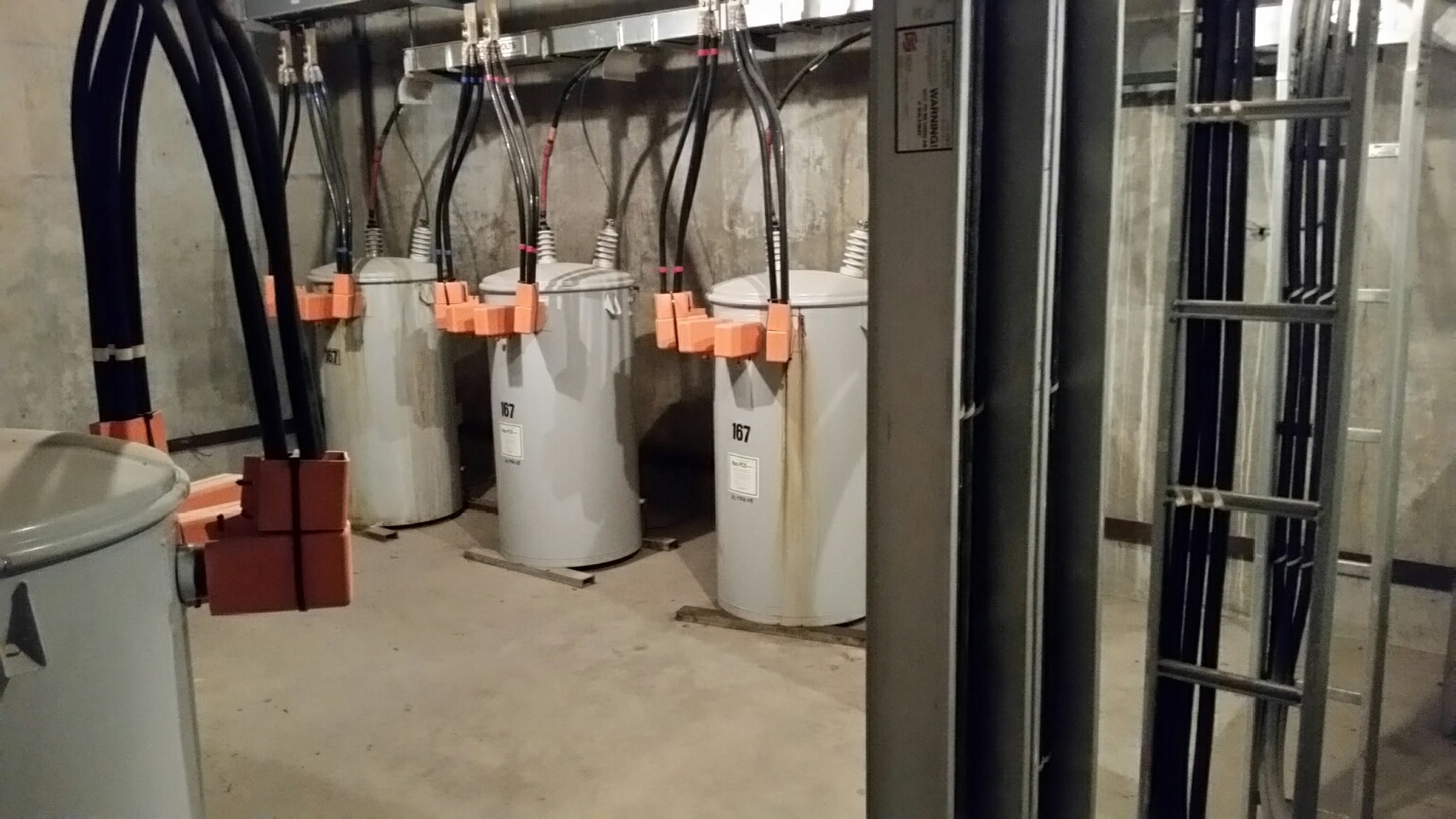

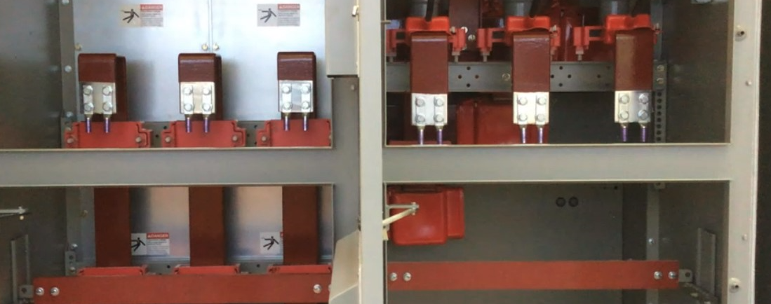

We have a handful of old installations on campus using single phase oil filled cans to make three phase power like you see in the pics below. We put the orange rubber boots over the paddles several years ago. In recent years we've determined in most cases we cannot open the doors on our pad mounted transformers while energized due to too high of incident energy. We discussed installing rubber boots on the paddles like you see in the pics below on our pad mounts too.
In your opinion, would doing this eliminate exposure to live parts?
We have over time converted most of our pad mount to external oil sample ports and drains so we can now take samples without opening the doors and we buy new transformers with the external drain but you still cannot see the gauges or see if you have a spare conduit or how feasible it is to add another feeder etc.
Thoughts?

I'll let others speak regarding the covers.
The installation depicted violates the two action rule implicit in the codes. Pad mounted equipment is built so the door must be opened and an elbow be pulled before one is exposed to medium voltage. In a substation, live parts are guarded by height or secondary guards once one gets past the fence. Here it appears there is only a single door keeping unauthorized folks away from the exposed primary bushings.

The rubber boots will help protect against inadvertent shock and could prevent an arc flash event.
The item I don't understand is your statement
How was the determination made? What voltage are the secondaries of the padmount transformers? NESC Table 410-1 lists padmount transformers as 4 cal/cm2 up to 600V and 601V to 1000V as 6 cal/cm2. IMO that is not too high of incident energy as PPE is readily available and utilities open many padmount secondary doors with no incidents.
I do like that you are ordering the transformers with sampling ports that are accessible from the outside.
My pics are to show the boots, not the pad mounts install I'm asking about. Oh, and in the pics the primary bushings are insulated. You can open the door to the secondary side of a pad mount without opening the primary side door. Have no idea what you are talking about.
I'll have to look into the NESC section you cite. Arc flash analysis yields much higher than 4 cals on the secondary usually. I have witnessed a secondary L-G fault on a pad mount secondary with my own two eyes that did not clear the primary protection. It did not clear until we reopened the primary feeder switch.
Oh, and we have 480Y/277, 208Y/120 and 240V delta pad mounts. All primaries are 12,470V delta.

Here's a photo of an inadequate, easily moved secondary guard. I understand the janitor was given a key so he could mop up after the rain blew in through the door vent. All gone now.
Where we still have single phase cans they are in vaults behind 2 locked doors. The first door is into a mechanical or electrical room accessible only to our maintenance staff. The second door, the vault door, is keyed only accessible by our high (medium, really) voltage electricians and me.
IEEE 1584 is valid when you have a much smaller enclosure than your typical padmount with three vertically oriented bus bars in close proximity, around 25 mm for 480 V systems for instance. There is nothing whatsoever about a padmount transformer represented by that data.
NESC relied on testing actual equipment for doing their testing. It shows MUCH lower incident energy compared to IEEE 1584 calculations. The tests were for the most part performed by and published by EPRI. Any EPRI report over 10 years old (and some even more recent) is available for download for free. EPRI compared the actual test results to IEEE 1584 and quickly came to the conclusion that actual testing is necessary for accurate results for this type of equipment. They did several tests representing various extremes and took the worst case values which are used in the NESC tables.
So given a choice between actual testing and a computer generated number that is clearly not representative of the actual equipment, which one would you trust?

.. Oh, and in the pics the primary bushings are insulated.
Agreed, they are insulated by air, easily bridged through contact. There is a voltage gradient along the bushing surface, from ground potential at the bottom to line potential at the top. This surface is and must be considered live.
Two actions. Good. Thought I was seeing daylight coming through the door in the last photo.

That's not the typical "padmount" equipment I've seen in the Eastern U.S. Here we can really break it down into "live front" and "dead front".
In both types, the outer doors are frequently if not almost always bolted shut with a pentagon 13/16" bolt head and there is also provision for a padlock which is almost always used. Sometimes I run into one without the pentagon bolt, particularly in industrial equipment where they freak out about the "oddball" bolt that is the same bolt head used on manholes, vaults, and I've even been told it's used in some fire department equipment.
Once the doors are open with "dead front" equipment there are several wells that accept elbow connectors (IEEE 386). The grounds, drains, etc., are all exposed even if it is "dead front". This construction design originated with underground equipment so it uses the same connectors and sealed designs.
With "live front" equipment, that's pretty much it. There might be phase barriers but usually there are simply bus bar stabs with NEMA bolt patterns and that's it. This design basically came from overhead "tank" style transformers with open bushings on top and the only thing new is a built-in enclosure (aka air termination compartment) surrounding the stabs.
Beyond that quite often I see a bunch of vinyl tape or sometimes rubber and vinyl tape, or a lot of duct seal wrapping the bus bars and connectors and then wrapped up in several layers of vinyl tape to make it look "neat", with or without some kind of rubber "boots", air gaps and all. Since there is no shield and over 1000 V you can carry surface charges, none of this garbage is doing anything, barely counting as a "covered" conductors, but it shows up where low voltage contractors, particularly older ones, attempt to do medium and high voltage work, often skipping out on drains and any attempt at voltage stress relief as well, figuring more insulation will somehow fix the tracking problem that their work causes. I'm not counting any of this stuff since none of it meets any kind of standard and just causes me a lot more work to strip it all off for access and then cleaning it all off to restore the connection to manufacturer recommended practices.
