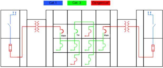

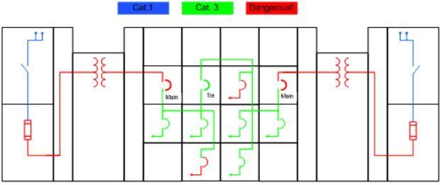

Utilities and High Tension Customers would find it impossible to perform only dead work . With OSHA 1910 clearances in place, portable ground application has moved to the 2nd most dangerous job we do . Racking live breakers in and out has replaced it.
Here is an example of what can happen
1 - Operator fails to check breaker open
2 - Mechanical interlock is defective permitting breaker to be racked out
closed
3 - PPE to the rescue

I agree that live work needs to be performed.
I have a problem with your example though.
We are saying that both human ignorance and human neglect is acceptable BECAUSE we have PPE to rely on. This will lead to the attitude of the easy way out, relying on the PPE.
I would like to know what was the predicted, calculated fault level and weather the PPE was appropriate to that level of protection. The above ignorance and neglect indicates to me that the person was also likely not to bother with checking the appropriateness of the protectiion he is wearing and he just plain got lucky. I would doubt if the copper slug - that is missing off of the middle phase - would have been stopped by that faceshield should it had enough energy behind it not only to completely evaporate but project it forward. Fortunately the construction of the vertical lift is such that it projects it downward. Was the upstream device functioning properly?
I would have disciplined the worker and the maintenance responsible supervisor.
Anything else leads to future endangerment of workers, and it is ususally management's fault as they fail to provide the financial resources and management demand for discipline, proper maintenance and replacing obsolete equipment.

LaszloZW wrote:
That shield is a Level 2 equipment and the gear you show needs Level 3 protection even at minimum available short ciruit duty.
The face shield doesn't look like a level 2 rated face shield. It looks like a standard face shield. I wouldn't even begin to guess the level of the equipment without seeing the study.
That face shield didn't do much to protect that guy because it didn't need to. Get arc rated equipment, if you are going to go into the benefits of proper PPE. He got lucky, this time. That's mistake number 3. He should have some time off.
You, of course, are right. On both counts.

Capt Jim wrote:
The ppe used in the incident was legit for the time and place . The opening section of NFPA70e states who is exempt from the regulation. We ( a utility ) are at present, but that will probably change. Reguardless of regulations this person went home uninjured that day, We celebrate this as an example of PPE benefits but we do criticize the lack of focus on the operators part.
As another poster pointed out the faceshield on the picture is a standard faceshield that has no FR rating. How could that have been appropriate? If that is acceptable for your Company then it is clear that their safety standards and practices are no adequate to protect people.

Laszlo, why do you assume medium voltage switchgear requires risk category 3 PPE as a minimum?
